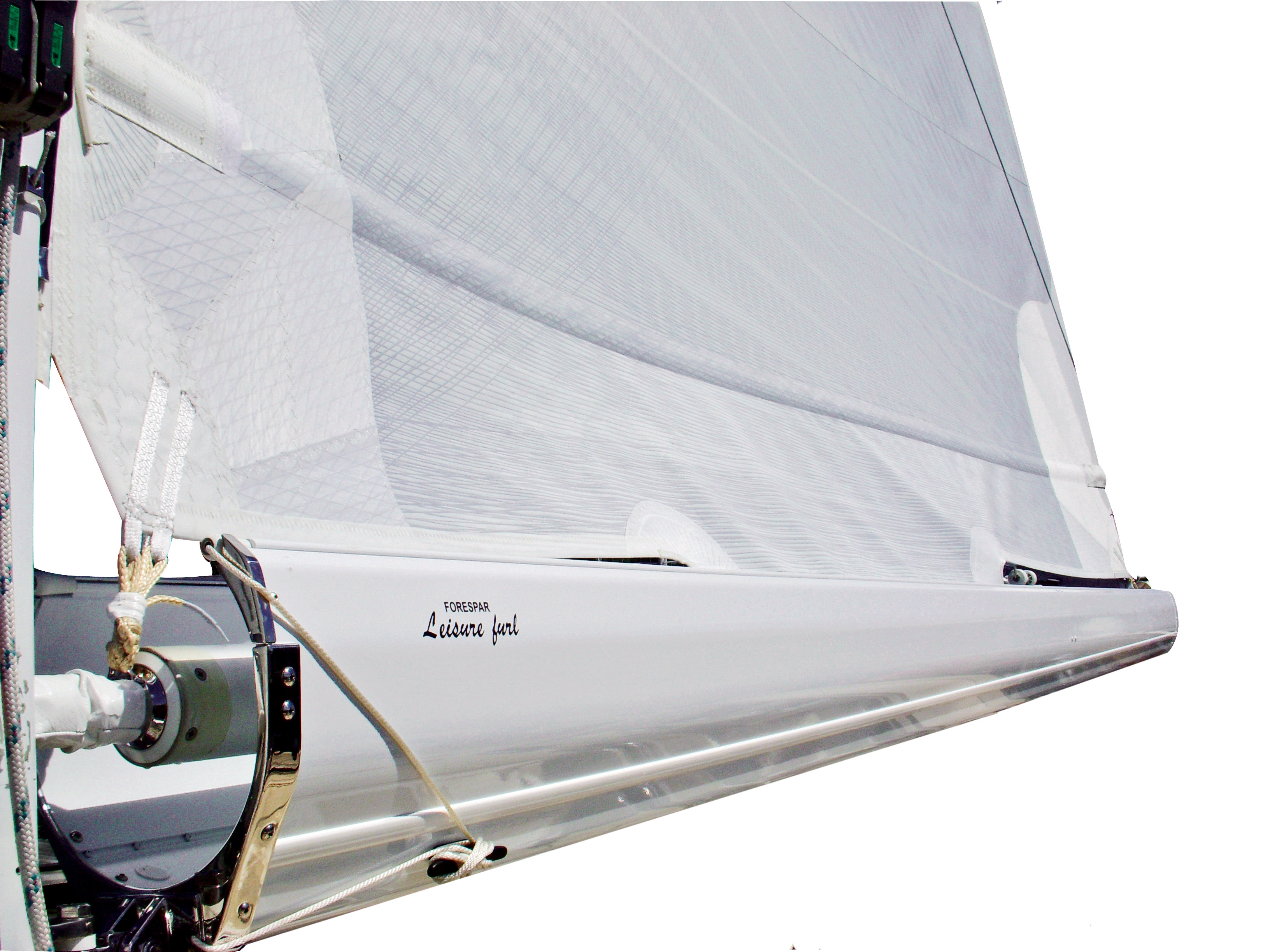

Forespar Leisure Furl:
https://www.leisurefurl.com/
[Imagen: Frspr-LeisureFurl-0312-3264.jpg]
